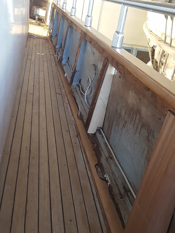

Bart,

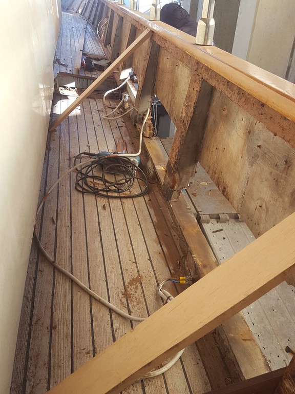

nice work, should keep bulwarks fine for another 20yrs!
however, on the above pics (the worse of the lot you posted) I can see that the outer skin of the ply is affected, you going to replace bits outside as well?
FWIW, in the similar situation on my aft deck I opted NOT to replace with ply, but with a sandwitch of alloy-rubber-alloy 4-5mm thick used extensively in shop fronts. End result is good to excellent depending on shapes, fittment, curvatures.
Extra bonus, you don't have to paint, and with 6-8mm countersunks you can remove and examine at will.
cheers
V.

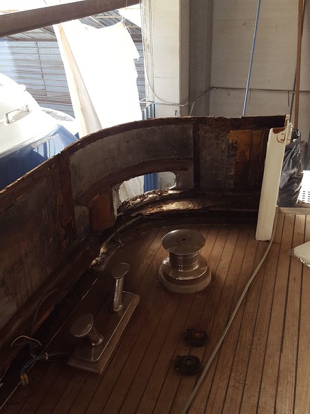

I must disagree, Vas. Imho, the worse area is by far at the stern, as per following pic:
It's not so much whether some outer panels are involved or not that would worry me, it's rather the fact that some bulwark frames seem to be affected, not just the panels.
Now, bulwark frames can be either applied on top of the deck, or they can be built as the prosecution of the hull frames, in a more structural way (so to speak), with the deck going round them.
IIRC, wooden built Canados (I mean, those with wooden hulls) used the latter technique.
Anyway, this doesn't matter so much with BA, because her hull is moulded.
For the records, back in those years (early 90s), the yard began building also the superstructure in GRP with the 58, which was their smaller boat. They kept wooden superstructures for a while on larger boats because their buyers would have turned up their nose to all-plastic boats, and they were willing to pay more for the wooden superstructure... Talk about a bygone era...!
But I digress.
Back to the point of the rotten bulwark frames, my concern is that if the water ingress has been enough to attack those solid and pretty large chunks of wood (possibly oak or mahogany? Do you know what it is, B?), I fear that also the deck structure (beams and panels under the teak planks) in that area might have been involved.
What is the yard saying about that, B?
Btw, obviously IF any deck beams are in need of replacement, it would be much better and more efficient to do that in the context of the bulwark rebuild, since the beams surely reach the boat sides up to under the bulwark.
Anyway, all the very best.
But I digress.
I wish I had the guts (and the budget!) for keeping a beautiful vessel as BA in top conditions, as you are! :encouragement:

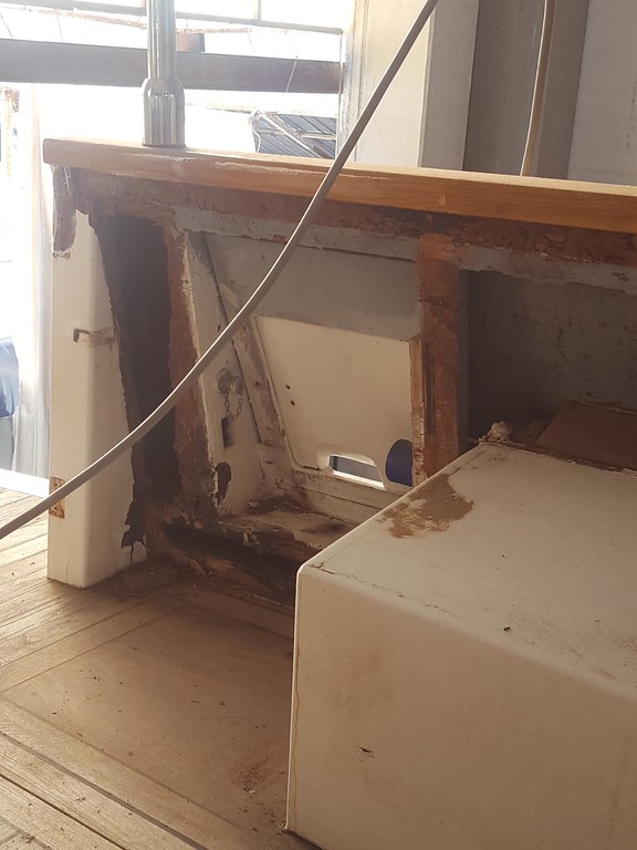

the stern quarter zones were bad, but temporarely refurbished 2y ago,
lately the most affected bad zones were around these side doors , in the cockpit area. (left side from the pic above) Even so bad that when someone was leaning on them we were afraid that the gunwale was going to fall apart...
I have'nt seen in the flesh yet, just on recent pics; some of the bulwark frames have been replaced with solid new wood, will asc what kind of wood that is, when I vist the yard, end coming week.
its indeed the plan, to also remove the old teak, inspect the deck floor, repair and place new teak.
The frames underneath the deck, are not necessary affected,
most area's we ve been able to inspect , had enough airflow / ventilation, all to be investigated in a few weeks

I just hope it's not like MiToS decks (soaking wet and rotten, but then it was water dripping in and soaking the lot for a number of years!)
Even then, deck (combo ply with top layer of thickish teak) was gone, but iroko frames under it were 98% perfect (iirc I replaced 3 in the whole deck)
cheers
V.

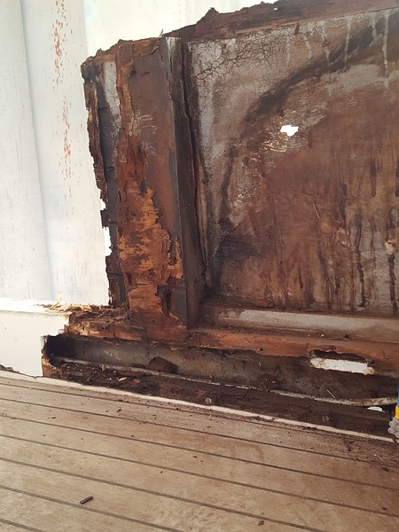

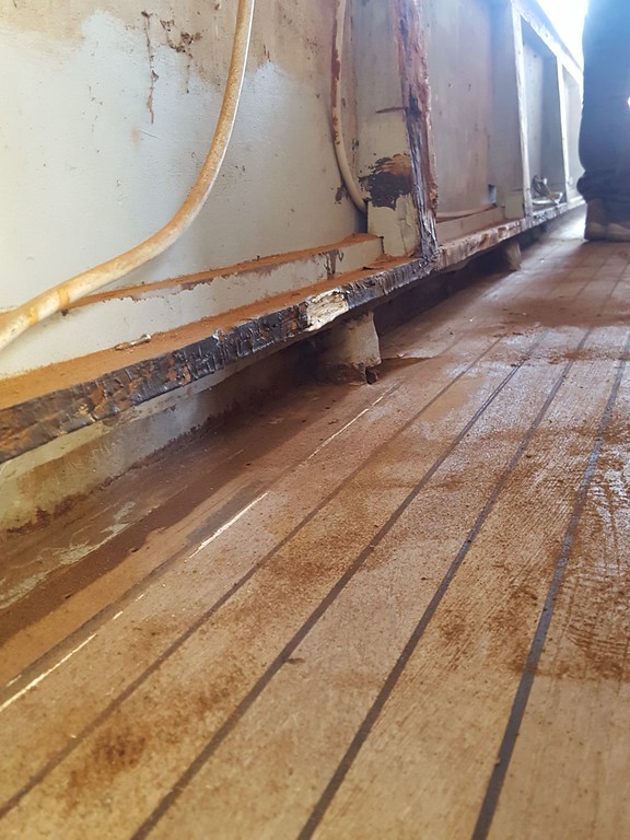

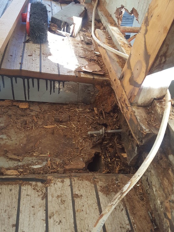

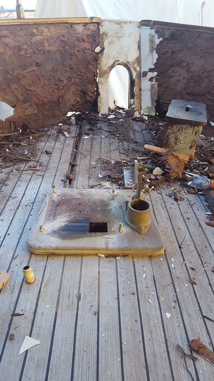

Here is the next badge of pics from the works:
these pics show that the wooden frames from the gunwale are fixed on a horizontal solid wooden beam, and this beam (partially rotten) sits on the edge of the GRP hull with GRP frames,
On the outside that horizontal beam, is covered with the SS rubrail.
I guess they kept this part, as a model for the curvation, so that the orriginal SS hawsholes fit.
remember this is quite solid, as it was repaired and reinforced with grp only 2y ago,
here they discovered a rotten part below the deck, this is the step in the side deck,
inside we didn't notice, so I guess the water disappeared behind the wall panels, or through the bulkhead wall, in to the bilges.
from the pics I think I can say that the yard is doing this job thoroughly, ;-)

definitely very thoroughly (I hope they're not v.expensive as it does look v.expensive...)

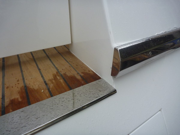

Bart, how was the joint between GRP hull and painted plywood setup originally? Just a ss U section or something like that?
I guess they are now going to paint ALL the bulwarks and colour match to the hull, right?
cheers
V.
actually they made me a very good quote (perhaps slightly worrying low)
so these pics make me feel good so far...
that horizontal hardwood beam, is visible on the outside,
and covered with the SS Rub rail
Here is the SS rub rail fitted
here that SS rail is off
and here is a cross section (from former work, fitting the transom door)

it was indeed time to get this fixed.
I was aware from the initial survey that this bulwark is a weak spot on the C70s.
Not all panels were as bad as the pictures show, but I'm gladd that the yard does it thoroughly without any discussion.
V.
remember the bulwark, aswell as the complete superstructure WAS painted,
we have already done quite a few touch ups,
so I have the NCS color code, and the corresponding Jotun color number
B, just FYI, I believe that the first course of deck planks, placed under and along the bulwark, is called "scupper" in EN - though I'm happy to stand corrected by anyone who knows better.
What I'm sure of is that "trincarino" is the IT term, just in case you might use it when talking with the yard.
Anyway, "beams" are something different, i.e. the transversal solid wooden bars which support the whole deck.
You must have a lot of them, under the teak planks, along the whole boat length - every half a meter or so, I would guess.
In your pics, the only visible deck beam is that bit of wood painted in grey with some black drips of sealant, placed under the step which was opened (see pic below).
You must have a lot of those, both short(ish) ones, under the walkarounds (as in that step pic) and longer ones, under the bow and the cockpit, going across the whole boat width.
Regardless, these are critical structural parts in any timber deck, and they are what I had in mind when in my previous post I suggested to have them carefully checked.
My concern would be that their external side, which goes under the bulwark, might have been reached by rainwater in places - though I must say that for what I can see in your pic of the step, that beam doesn't seem to be affected.
And as I said, my suggestion is actually just an egg sucking lesson, for any experienced yard - as the one you choose surely is! :encouragement:
PS: the IT for deck beam is "baglio" (plural: "bagli"), just in case you would wish to ask them to check if all of them are solid and don't show any rot signs...
