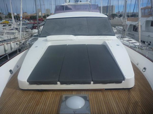

New sunbrella on the bow cushions

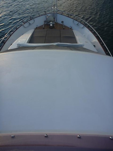

Alfonso has painted a new anti slippery paint, (the old one was crackelled)
On The wheelhouse roof

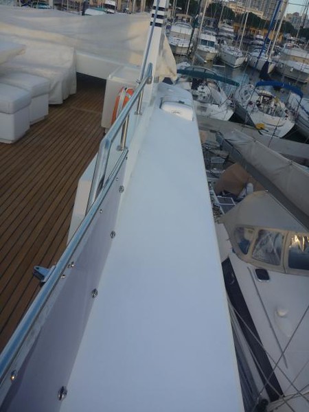

And on the side deck roofs
Some holes from old antenna’s have been filled but not yet polished (not clear on the pic)

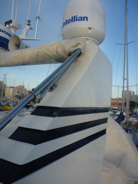

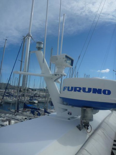

This is a detail of the new scanstrud radar pole on top of the radar arch

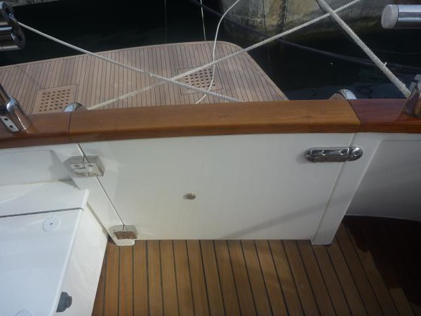

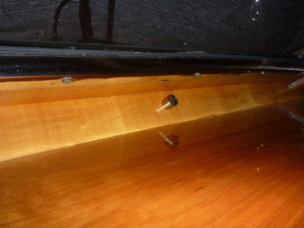

Have you noticed this detail, the curved solid teak on the gate door capping

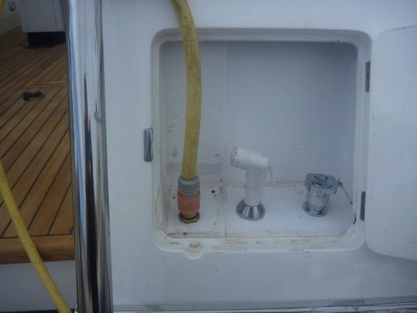

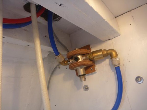

This was MapisM suggestion, a connection for the water hose, so that our water distribution has real fresh and drinkable water, we can make coffee with water from the tap
But we added a pression stabilizer and a one way valve

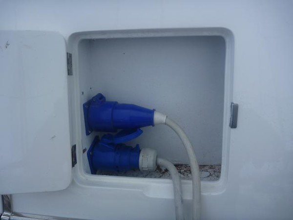

This one is for sure a solution for Deleted User, a second power connection,
Very handy here in Toulon, power con’s are only 10 amps each.

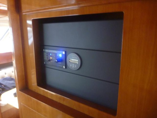

Remote control for the Victron Invertor / charger,
With a shore current limit set at 10 amps !!! (has been very usefull this weekend)

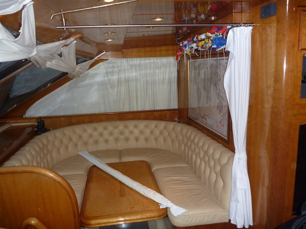

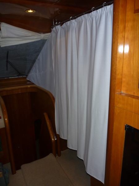

We finished the curtains for the new extra copilot bed (courtesy to jfm)

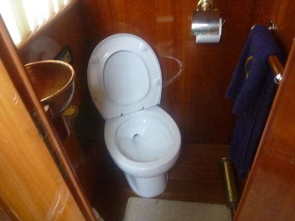

And in order to avoid the wakeup of the complete Toulon Marina,
we replaced the old retrofitted cheapy and noisy toilet on deck level
with a real tecma

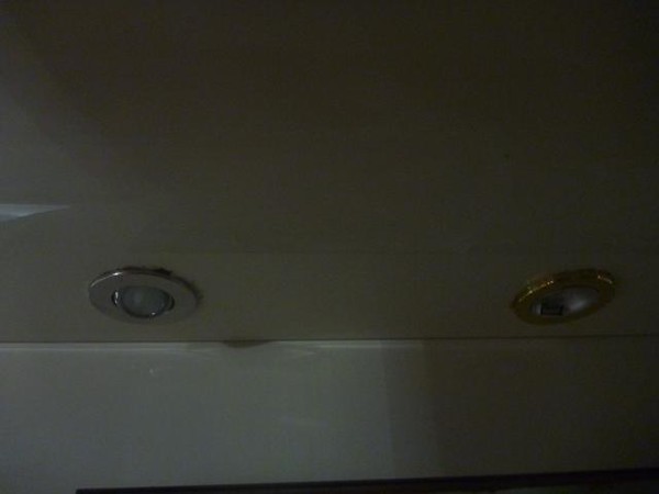

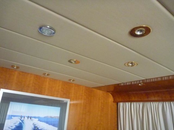

we have been testing all kinds of Quick led lights, some are good, some are bad, will report on that later

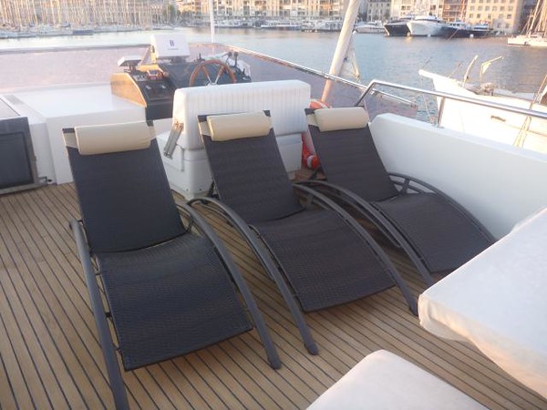

New sunbeds on the flybridge (really really expensive in local Carrefour :D )

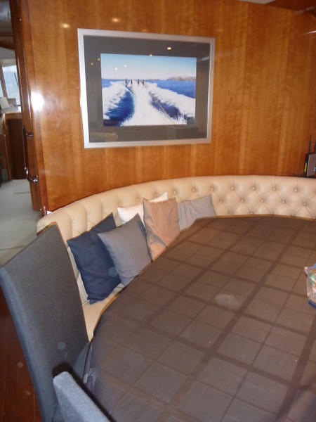

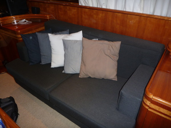

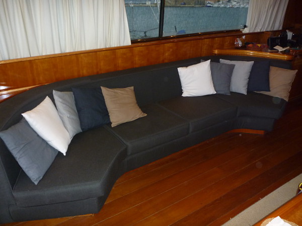

And last but not least,
To fulfill the generally accepted
high level forum standard,
(Deleted User don’t read this pls)
Our self made Scatter cushions;
They even make the leather sofa integrate with the new color scheme
Can I apply for a OB rating now ?
Or is the boat and her captain too old for that :eek:

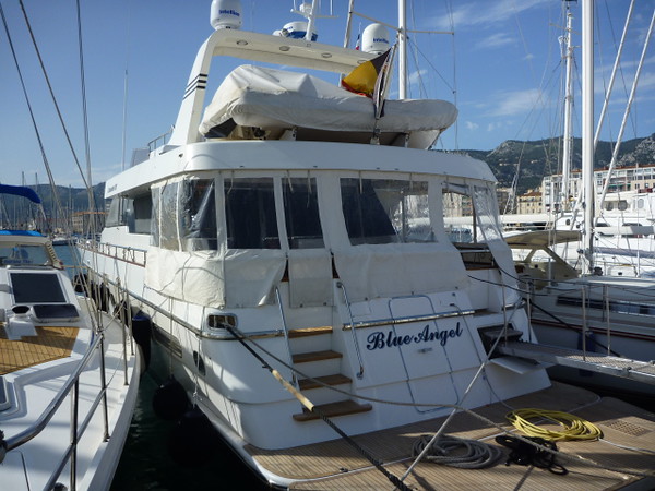

we have modified the old existing cockpit covers;
new and a lot more windows,
(there were only 3 small ones, and they were milky and yellow)
also new zippers and a good cleaning,
appeared to be very usefull last weekend;
Q.
would like to leave the cockpit covers "on" during long unused periods,
but I'm afraid that wind will damage these covers.
so I'm looking for a nice and clean, but reliable fixing system
to fix the lower edges of the covers on the hull,
its obvious that it needs to be easy fittable / detacheable !
idea's are welcome, thanks !

[NerdAlert] Is that the new soft-close lid on your tecma loo there? Is it any good? [/NerdAlert]

Rafiki uses a series of bungy attachments to fix and tension her rear canopy. Sorry, don't have any pics handy. This appears very wind and weather resistant.
Yeah but can you sum them together to power aircon?
no need to if you have a Victron (multiplus), that can give extra power from the battery's needed to start up the airco el motor.
or even simpler, fit a soft start on the airco motor.
but in any case, you would need the two connectors
me wants sunbrella! they do look the biz. mind sharing the colour code plz Bart?
Bart &/or MM, care to explain how that works? I vaguely remember somewhere MM saying something about it and how you cannot flood and sink your boat using this system but I've lost it.
