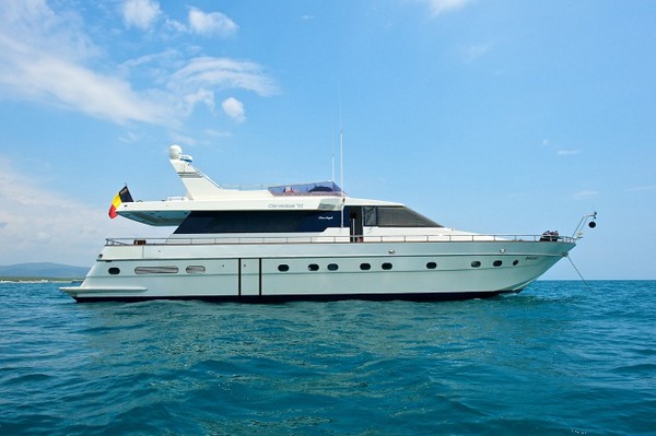

Bart, out of curiosity, do you have a pic of BA on the hard where you can mark the approximate position of the e/r bulkhead?
If you'll decide to go for fins, I'd try to put them in the e/r, rather than in the master cabin.

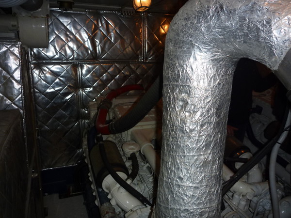

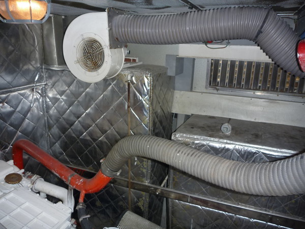

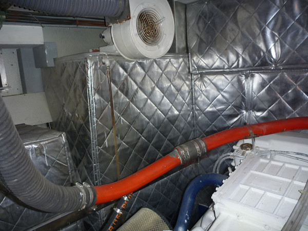

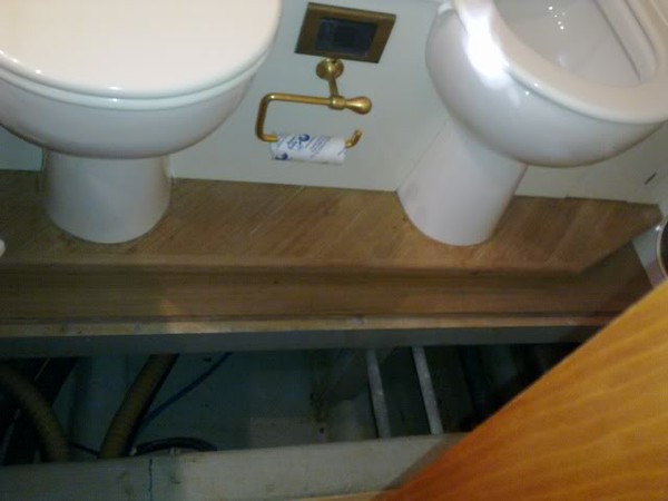

Here a pic with the position of the e/r bulkhead (aproximately)
There are full beam fuel tanks,
Behind these are wing water tanks, and extra wing fuel tanks,
very limited space between engines and wing tanks :

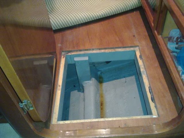

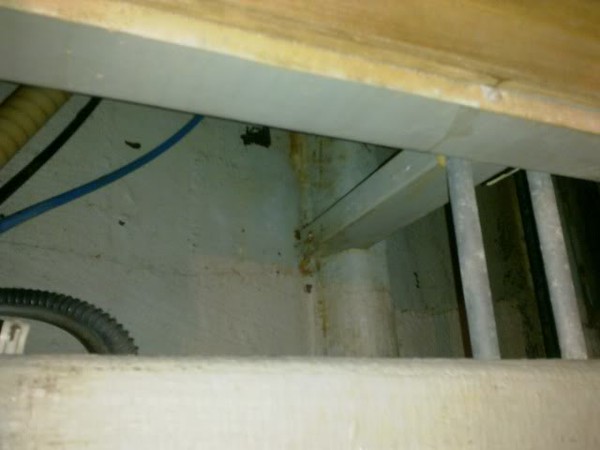

but the relative position on Match is more or less the same is in my master cabin bathroom / dressing room.
(not sure about weight distribution in a C70 dough)
SB side:

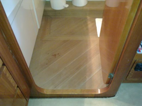

and dressing room on P side
if the position here is right,(weight distribution wise) In believe its doable
Yup, under the floor in bathroom/dressing room makes much sense for easy install and service/checks. Plus easy access to make the GRP reinforcement of the hull.
The fins would be roughly as below, which looks/feels same as mine (bottom pic). The two pics are close to perfect scale and the transoms are in line! You want to avoid having the fins too far forward else they can try to lift the bow but I'd say your boat with red square below is slightly better than mine on that point, and i have no problems with them being too far forward.
