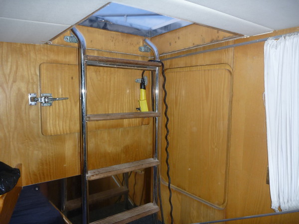

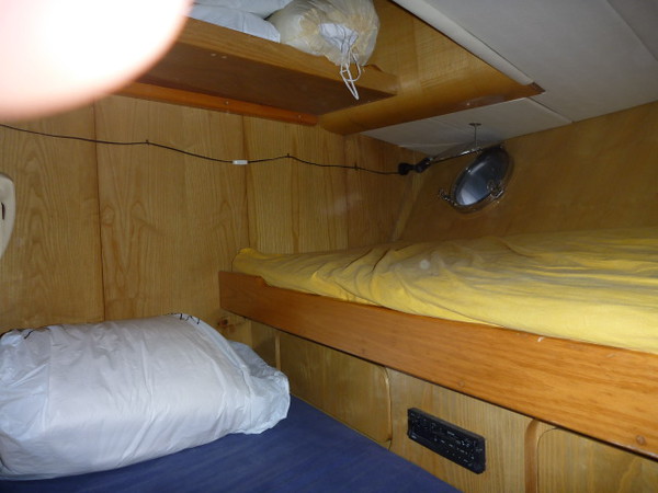

2) Fresh up the crew cabin,
As this cabin has been habited the most, crew permanently living in there,
This cabin looks too much warn.
From time to time this cabin will be used by guests, and therefore we would like to give a thorough refresh.
Our idea was to soft sand all wood veneer , and give it one or more layers of “white” varnish
Any “fresh” idea’s are welcome !
Here some pictures;
