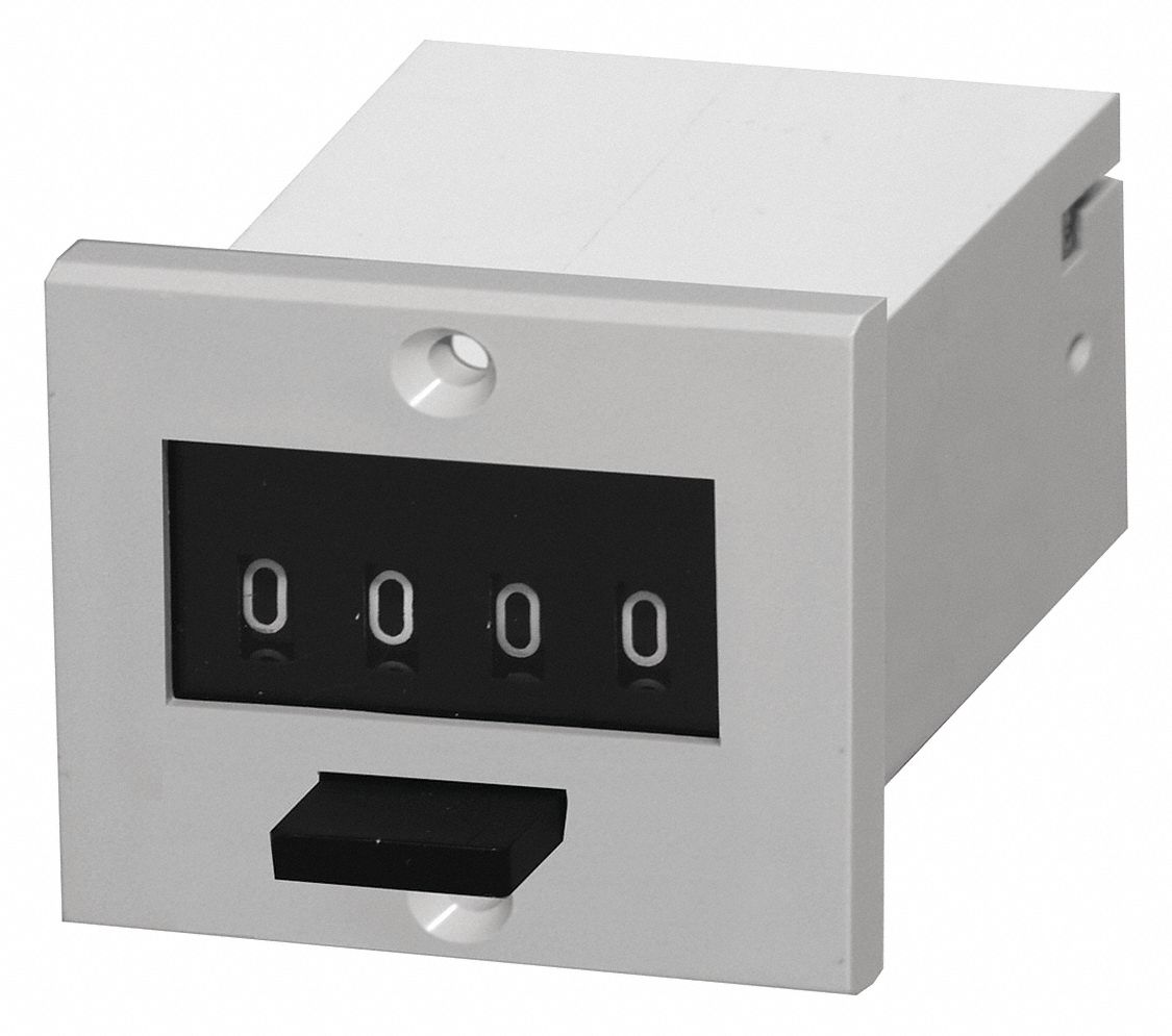

If you fit an automatic bilge pump, consider also fitting an electromechanical counter so if a leak develops that you can determine how the leak is developing, and action need to be taken
