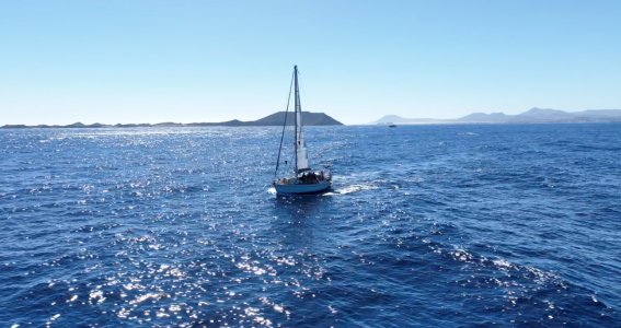

You may have to check local regulations, but wouldn't a drone be a decent option? Instead of big optics, just get the camera closer to the target.
Gives you the option of taking pictures from less common angles as well.
(From a recent drone shoot of us sailing in the Canaries. Shame the winds were super-light that day)

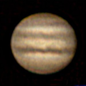

From my back garden, Nikon D5600 DSLR on a Meade f10 10" LX200 telescope at prime focus.
Just too heavy to be properly portable, getting a good solid tripod makes one hang of a difference, on a light tripod the gentle breeze can shake your camera, the higher the zoom level the more stable you want your mounting.
"Cost effective" lenses can be fine until you are using them at the extreme end of the zoom when a lot of them go soft in focus and contrast, My Sigma 50-500 zoom lens cost a good bit more than the camera but at max zoom it is soft so I tend to avoid using it at that setting.

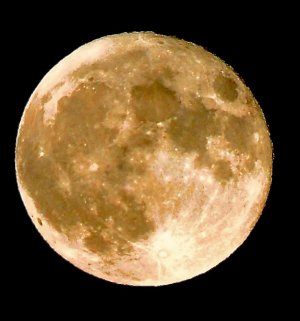

I've got a Canon Powershot SX520 HS. It has an enormous zoom range; too much for hand-held photography; for best results you need a tripod. Does good nature photography and this is a photo of the moon taken with it (cropped)1000010305.jpg
