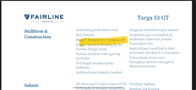

Targa53: 12.5deg deadrise aft (that sounds too flat…strange)
If you're referring to the boat in the Bulleri video, that just can't be true.
According to that video, the efficiency of the boat (max speed for weight/size/power installed) is rather low - almost embarrassingly so, frankly.
And while I guess it's possible to build a flat and inefficient hull, that's MUCH more typical of deep vee boats.
A boat like that, with a 12.5deg deadrise hull, should reach the high 30s without sweating.
The fact that she barely reached 32 kts in the test suggests a much higher deadrise.

I know it sounds wrong
But it comes from Fairline website
Urgh, that's puzzling. I mean, these guys, many years earlier, produced the Squadron 58.
A flybridge with no sporty ambitions whatsoever, but with a 18° deadrise and capable of 28kts cruise/33+ WOT (as tested by MBY back in 2001).
Much heavier and larger, and with just marginally higher power engines.
Makes one wonder what's wrong with that T53... :unsure:

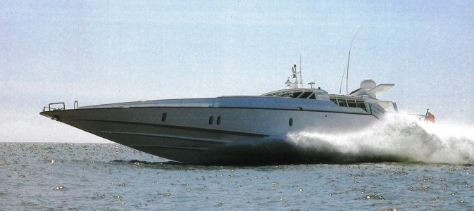

I will leave you with this pic returning from St Trop one day ….
Although the sea state is calm …..this is pulling the other string on the deep V trio club bow , the oversized engines = speed . I am actually going through him (uni rowing days term )
Crept up behind at 28 knots my eco speed once he saw me sat in his wake a few hundred m back - he turned up the speed to 30 , so I mirrored him , them 32 then 33 / 34 he maxed and I pulled out of his wake and went straight past .
For sure he was 9issed .
Oh what a joy .Once a mile ahead I went in front so he could eat my wake …..he dropped right off assume back to 28 ? …so we just lengthened our lead back to Cannes way .
