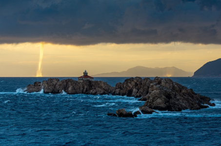

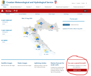

Seen them a number of times in the Adriatic over the years, probably about 10-15 in total, and sightings can be reported on the Croatia Meteorological and Hydrological Service website (where the marine forecast can also be found) ....
You don't want to get hit by something like this in the middle of the night ...
PHOTOS: Epic Croatia Weather Photography Stuns The World - Total Croatia
It's always something in the back of my mind when the marine forecast predicts "isolated thunderstorms". I usually head somewhere where I know it is sheltered with very good holding, or head for a marina.
This was Rovinj in 2013 ... within spitting distance of where I was anchored in the earlier video .... (not my video)
