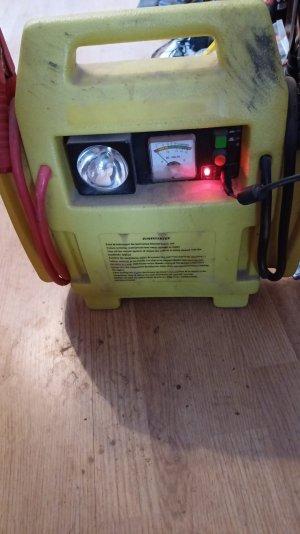

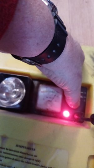

I checked this morning with my Halfords Load Tester ..... shows 4 full green led's .... both seem to have recovered. Will need to put into service and see what happens.
Decided to revamp my old Emergency Jump Starter .... it has a 12v 17A/hr SLA .... - new battery in and she's good to go ... even found the old charger for it ...
