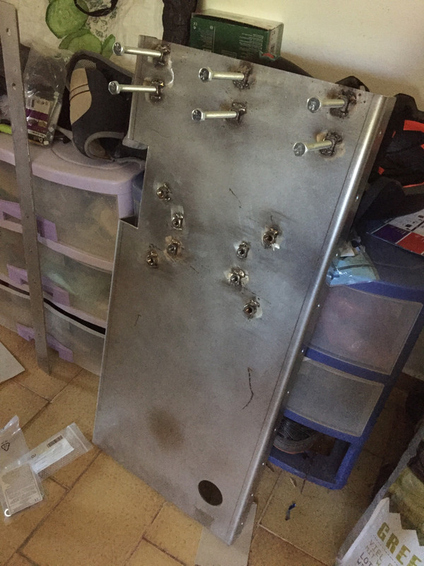

As an alternative to tapping a thread....is welding a captive nut....here’s one I made earlier...
Thanks, Bouba!
I don't have welding kit, so I simply used a blob or two of JBWeld, as in #15 although that's not shown.
We're 'on the same page'.
