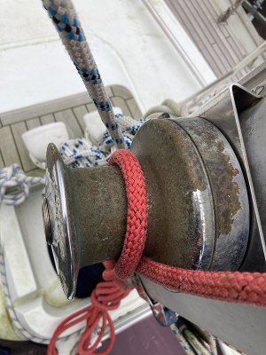

I have a pair of Lewmar 16s that could do with the drums re-chroming. Anyone had some done of late and care to make a recommendation?
Have read some old threads on here and I’m aware how important it is to tell them to leave barrels ‘textured’.

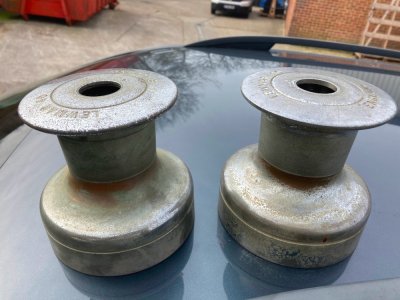

Just to update. Was quoted £300 incl vat by Ashford Chroming to do two Lewmar 16 barrels. Postage to and from is not included in that so I think with insured courier possibly another £50 on top. I will ring around a bit more me thinks.
Hmmmm. Lot more than I paid.
Edit. Prior to Ashford I had a pair of L43s (& other bits and pieces) done by this company, AM Philpot.
Hard Chrome Plating - Hard Chromium Platers - Functional Chrome Platers.
Maybe worth a try.
