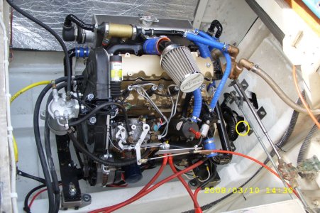

That was a peugeot xud9 that was freshly marinised, the pic was when it had just been dropped in hence why so clean.
It was the first one I found showing the outdrive from inside, it was a home brew marinising job on a pair of car engines I had rebuilt, not had the boat for a good few years now though as wanted a bit more speed and better sea keeping.
