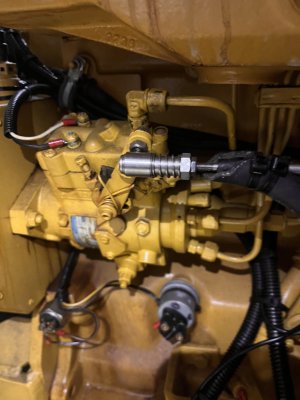

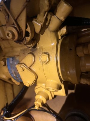

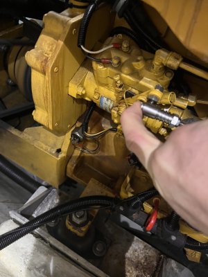

So I removed the air filter and had a look at the vanes. Looked and sounded just fine. Removing the air filter did nothing to remedy the problems either. No surprise as I cleaned it properly about 150 running hours ago.
I then proceeded to remove the control cable from the fuel pump control arm. And woila! I could operate the engine as nothing had happened. It reved up and down like a racecar! No hestitations even with full pitch applied. So we have been barking up the wring trees here. Surely iy must have sufficient quantities of both air and fuel?!
But I dont understand it at all. The control cable is putting the control arm in the same positions as I do by hand :S
Once I connected the control cable it is not reving past 2000 RPM`s! Makes no sense to me.
Control arm going all the way to the high idle stop screw. But the control cable is connected and it wont rev past 2000 RPM`s.

Refit the cable to the remote control
take phone photos for comparison
check for missing split pins and or locking nuts
if you can get fitting instructions it will make setting up easier
