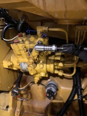

To be fair K, I think John Peet has the right of this. If you remove the control cables and the issue persists then it is very likely that the issue is within the HP pump, having ensured that the fuel and air supply is both clean and free flowing. I note ( though it may be photo angle) that in the photo's you posted that the angle of movement of the pump control appears greater in the manual operation then it did in the cable operation. Are you sure they both came up against a stop and was that an internal or external stop?
For my two penneth I would check the stroke of the HP pump lever several times with the cable connected and physically disconnected as suggested by JP above to ensure that your getting full stroke consistently.
If this is OK and nothing of detriment can be seen or felt that positively applies to the HP pump then prior to removal of the HP pump for bench testing I would obtain a hand held tacho just to ensure that you are getting reduced revs etc. Yes you can no doubt hear it in the engine but that doesn't come over on here and the speed of drop of the tacho in your vid really was very very fast. The hand held agrees with the panel display then its a good chance you have an issue with the HP pump , ie governor spring or misplaced weight etc etc....
Yeah I am sure. It is a external stop screw in both direction so easy to be sure :) One for low idle, and one for high idle.

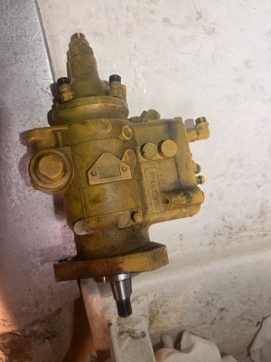

So fuel pump is out and sent in for overhaul.
Consider taking out the nozzles as well, but they seem to be quite stuck. I wonder if it would pose any danger to turn the engine whitout the pump attached? That should push the nozzles out :)
Pump is overhauled and installed back in place. Turns out axle had a bit of wear and tear in it.
