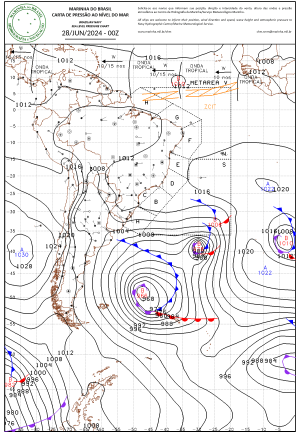

At the time, Brasil was officially supposed to send SLP and SLP+24h charts via fax, though I could never receive them (nor hear any signal). Instead, via email I queried FleetCode files from the Brazilian Navy, quite nice product: small bit size, ITCZ position/intensity, text forecasts for various sub-areas of Metarea V and a very nice synthetic SLP chart of the whole South Atlantic (though of little interest to me, we remained in the tropical area). Unfortunately they stopped making them available.
Brasil SLP charts are available here (and nice too), but at >200kb it would be either Starlink or some crop/resize :)

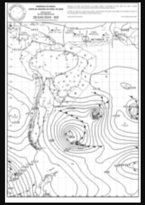

This is shrunk down to 7.5% & converted to black & white with a quick few lines of python, size now 12.5K. 5% is 6K.
Blurry but still readable & very useful so could well be worth an evening getting some python to run in the cloud & make your own synoptics for saildocs to download over HF :cool:
