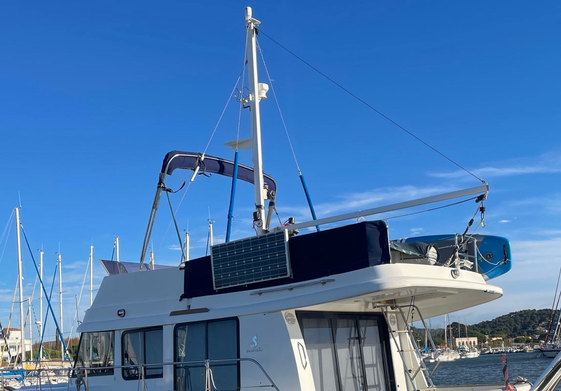

I put my solar panel on a rail frame that can be tilted to face the rays or folded flat...the flybridge rails are the best place because they won’t interfere with neighbors when Med berthing

I fitted 4x150 watt semi flexible solar panels to our flybridge "eyebrow" - see in this pic:-
On a good day - and I mean on a GOOD day (in the middle of the Med summer) - we can harvest a little under 3Kw hours (3 domestic units) per day.
My point is that our 600w of solar panels isn't enough to keep your fridges running whilst you are away.
