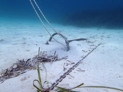

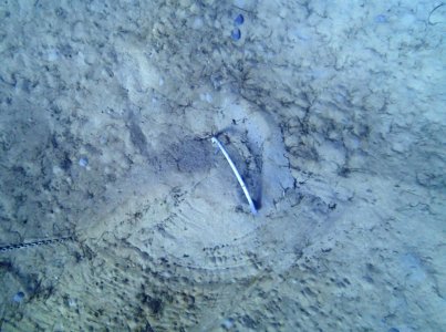

With a significant change in the direction of force on an anchor it will normally "shuffle" and remain buried under the seabed as it rotates around to a new direction. There is no need to reset the anchor, as it does not typically break out.
The photo below shows this "shuffle". The semicircular arc of sand in the bottom of the photo has been caused by the anchor shank of my Matus M1 anchor rotating under the sand (in this case over about 120°), as the wind has significantly changed direction.
This "shuffle" happens only when there is reasonable force on the anchor. Generally tide alone is not sufficient to change an anchor’s orientation, nor is a change in direction when the wind is light or even moderate. The photo below shows the typical underwater appearance in these conditions. This was a Rocna anchor on a large catamaran. The anchor remains unchanged even though the boat and chain will move around to other side of the swing circle.
Your post seems to be based on good holding in sand in good conditions with very little tide. Anchors break out all the time for various reasons, and a good 4kt tide will certainly do more than shuffle an anchor gently in a circle
