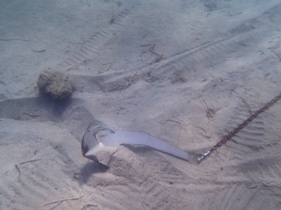

The bottom line is that you do not want an anchor design that breaks out with a change in the direction of pull, whether from wind or current.
Some anchor designs develop a very high list as they shuffle in response to a change in direction of pull. often these designs never set well. There is a greater risk that the anchor will break out completely. If this happens the anchor has to try and set while moving rapidly. A difficult job for any anchor.
