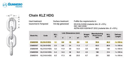

I used to sail a 37 catamaran. To maintain good sailing performance, it was essential to minimise weight. We kept the boat super light. Plastic plates and glasses, minimal spares, foam core panels under bunks instead of marine ply. Foam core doors, table, shelves, etc We had a saw you tooth brush in half to save weight sort of mentality.I don't expect you to take me seriously but I's go for G70 x 8mm - and I am serious.
A decent snubber will replace catenary, the weight and space savings are large.
Your yacht has a similar windage to our 38' x 22'6" catamaran - and we used 6mm
