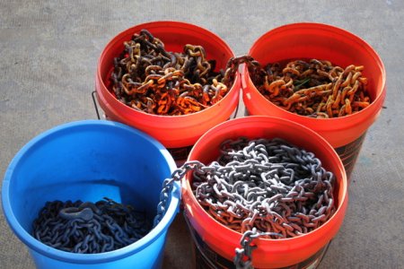

If you intend selling your current yacht - don't bother to change anything. If I had a Bav 42 and it was a keeper I'd change to high tensile 6mm which approximately has the strength of G30 8mm. The simplest chain would be 6mm G70 which Jimmy Green should be able to supply, we had a 38' cat, 7t, which has the windage of a Bav45/50 we downsized from 8mm to 6mm.
This what 75m of 6mm looks like, bottom 2 drum in comparison to 50m of 8mm, top 2 drums..
