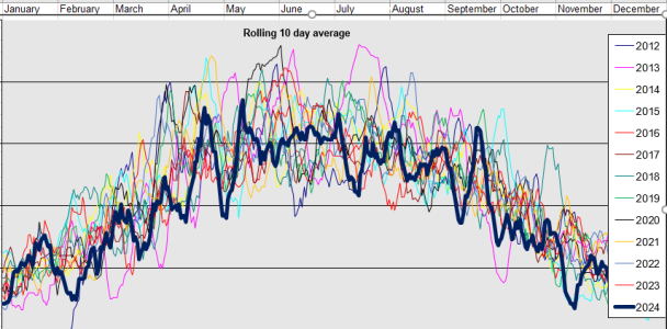

If the old battery has been flat for any length of time it will have reduced capacity. You need enough capacity to cover about 10 days of dull weather so a 100Ah battery with 50Ah available will give you an average current of 0.2A for 10 days. If the camera draws more than this you need more battery capacity. Also think about adding more solar as it has now become very cheap especially for the large house size panels. If you have a controller and orientate for the winter then losing a bit in the summer will not be a problem.
This is the output from my house to give you an idea of the variation.
A 100W panel will give an average daily output of about 0.2A in winter but up to a peak of 8A in summer so will need a controller. If the panel is smaller than this I don't think it will cope with a dull winter period.
