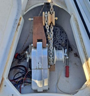

I’m looking for a print file for 8mm anchor chain gypsy, currently searching web but not sure where to actually look, hopefully there are some 3D printing experts on here

I’m not looking to drive the chain but just have it as a free running chain pulley,

They are just shipping their first batch, I’ve spoken to them and they have a waiting list until probably the end of this year, cost is approx £250,
The idea they have looks really good, the upcoming chain drives the tail end back into locker at the same rate,

If you want to make the double gypsy for the chain distribution mechanism linked above, have a try with hard rubber rollers of trailers for motorboats: take a wide one, put a round separator in the middle and add some indents (that s what I am doing anyway, seems to work).
I did think or hard rubber but thought that it needs to index both upcoming chain and tail end at the same rate
People are very quick in claiming ideas as their own original ones, for the sake of trying and be fair in the internet jungle, the original idea came a few years earlier by someone else who simply let others know about this method he had found (yes internet has chronology).
As I have a Cayman with its hole on top of the case, I am trying this diy variation; others put the rollers on a bar across the top anchor locker.
