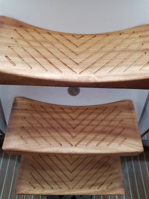

I have companionway steps which were machined out of blocks of iroko and they have been fine.
