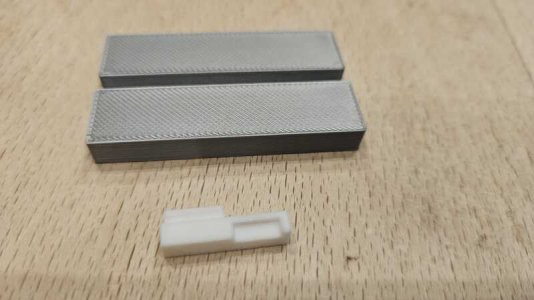

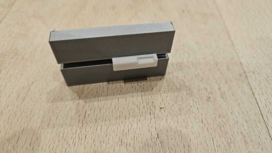

I couldn't bring the boat home so I decided to make a test piece in the form of a block.
In the following photo, the test piece is silver and shows the new piece in white.
The new (white) piece can slide within the test (silver) piece.
Here they are again - this time separated.

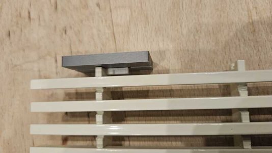

So that little print is for a Classic Style Fairline Squadron.
In those days, they secured the A/C vent grilles by creating slots in the recess where the grilles are located.
The grilles themselves are made from powder coated alloy with small cutouts.
These cutouts can be located into the slots within the recesses and held in place with the small plastid sliders.
Not tested yet but the new prints are so similar to the original ones that they should work.
I was impressed that we can accurately make such small items using 3D printers.
That FreeCAD design took me about half an hour and the sliders (20 of them) took about 15mins to print.
It took longer to make the test block piece - I made the slot a nice snug fit for the original slider - then made the new slider design to fit the slot.
You have to think like this when working on the boat 1000 miles away.

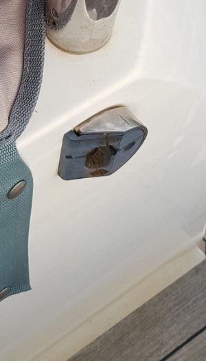

My next boaty project is to make some replacement plastic buffers for the cockpit gates on my Princess.
I need to replace the black parts in this photo:-
A few years ago, I tried to source some and failed.
I've still got the bits (broken) so I will make some - probably using ABS.
