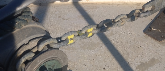

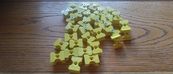

evening all,
fwiw, I designed some for a 10mm ISO (may fit on the other DIN but haven't got one to test) Test fitted them they look fine.
In the pics I was using 3X12 self tapers, now ordered 2.2X9 SS ones and have modified the recess accordingly. this way the screwhead is less visible.
Mind I recon unless you're by the windlass you've not got much of a chance of spotting them. I'm usually dropping/retrieving from the f/b but even on a 43ft mobo they wont be visible (imho)
if anyone wants the STL files PM with your email so that I can send over the 25kB zip (cannot upload zip files in here)
cheers
V.

That’s really good
Just thinking a really low tech chain counter would be a camera so you could watch the inserts go by.

That’s really good
tbh, in stern to mooring or generally med mooring, there's no time to check at a screen like that, you can barely check a 4in screen with the meters displayed every now and again.
I'll mainly use it to debug why my custom arduino chain counter (magnet on gypsy, sender fixed on the housing type) miscalculates by 2-3m at 50m chain drops :cool:
usually misses on dropping the chain (not free dropping) not that 3m at 50 is something to worry about, just annoying!

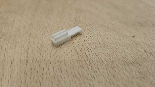

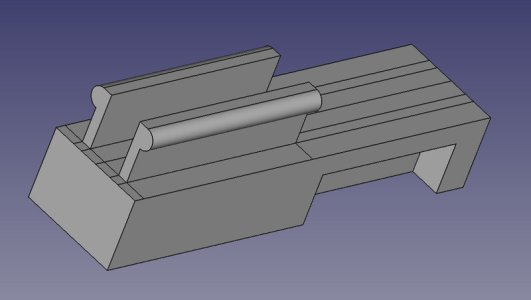

Window related?
I've just got back from the boat with a bunch of things to design (in FreeCAD) and make for my next visit. Whilst there I installed my custom Axiom bezel that I made in ABS, and it fitted perfectly :)

Window related?
We got back on Friday - yep lots of stuff to make with the 3D printer. My 3D printed solar panel glands were a success. Printed using ASA so we will see how UV safe that is!!!
The new pre-release version of FreeCAD is now getting really good.
Back to my challenge - that new part is for a friend's motor boat - I won't say the brand name yet though.
