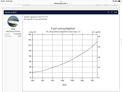

It’s very useful to know if the boat reached rpm at wot .See my post #4 .
Also see post #11 bt SC35 , the graph .
SC 35 failed to mention it only applies if the boat reaches rated rpm at wot , which is what I said .
If it doesn’t then this graphs pretty meaningless .He’s gonna be up at the higher end or over of the ranges suggested .
The graph quite clearly says "at calculated propellor load".
If the boat was failing to reach rated rpm at wot then the propellor load and the curve would be different.
The graph is only indicative anyway, as it doesn't take into account "hump speeds" of actual hulls for example.
That’s the point we don’t know the Op s boat it’s reaching rated rpm .That’s was my point waaay back @ post #4 .
Fast Fwds 10 - 20 yrs and there’s a risk said OP s or anyones now can’t.So invalidates using manufacturers graphs .
Those graphs assume rated rpm is achieved.If it can’t reach rated rpm the fuel burn gonna be higher across the rev range .Worth knowing imho before doing the range maths

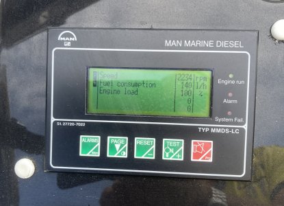

.Before anyone bites my head off of course I only have pics / info of the infamous Itama , why would I not ?
Show me your rated rpms at wot guys !
This is what you need to see first to validate your engine manufacturers graph .
WOT for me btw 2200 . 20 yr old tub with 20 y old in excess of 1000 hrs engines .Taken last Sep , boat into the water early June .No pre sterngear / hull cleaning , just taken out “as is “.
Just the top line from your tachometer or better still if sea trialing an engineer with a strobe in the ER checking tacho calibration .I realise not everyone’s got screens or an engineer like VP tucked away with a strobe in the ER .
But I will accept a tachometer pic only .
From the Ops maths roughly 2000 L full tanks he thinks he will burn 14/1500 L leaving an acceptable 500 L , 1/4 left .
This is working on 8-9 L NM , of which there’s no disagreement .
But if it’s effectively overloaded by a figure yet to be worked out because we haven’t got the rated rpm , …..and he sets cruise at 25 knots he might eat up a large quantity of those 500 L a dangerous quantity.We just don’t know .
Esp if 1900 rpm is giving 23 knots and there’s big ( ish realise to boat size ) waves on the nose , a strong wind on the nose , poor new boat to him trimming etc etc To get to 25 knot it’s gonna need 2000 to 2100 rpm + with full tanks .

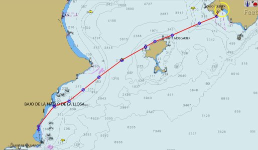

Actual route taken:

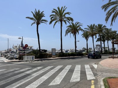

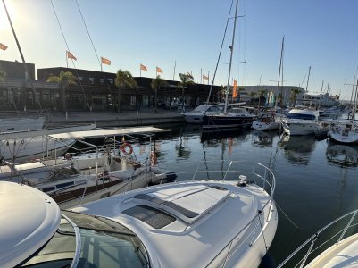

Plus a few shots taken on the way:
First is Portals Nous marina - Last is proud new owner in Puerto de Las Salinas:
