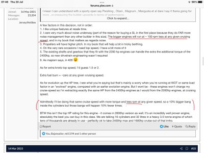

This one ?
[Your 2600 Hp taking only 2000 Hp will run at lower rpms than the 2200 hp taking the same 2000 Hp .So will wear less AOTBE.]
But you are agreeing with me here , taken from your SL thread .
Those sports fisher guys are usually talking garbage, as is very common on US forums.

This one ?
The part I was (obviously) disagreeing with was the "So it will wear less". Yet again, you post some evidence in support of your argument (in this case a post I wrote in the SL thread) without realising the evidence is working against your argument not in support of it.
All I said was the bigger-rated engine will do lower RPM, aotbe, which is obvious, but that is not saying it will wear less. Wear and RPM are different things; explosion magnitude (inside the cylinder when the firing happens) has lots to do with wear. You've even highlighted the bit where I talked about size of bangs inside cylinders.
Last time you posted evidence that hurt your case, I suggested you check which way the gun is pointing before you pull the trigger. Now I can see that you don't know anything about guns, and don't know which end the bullet even comes out of. You just post things that relate to the debate, wishful-thinkingly hoping they support your argument but having any clue whether they do or not. I need to give up! Enjoy your 80% load setting (without having any clue what that 80% is 80% of) and let's not worry about any of this :)

There are less “bangs “@ lower rpms , you said it yourself .It obvious it’s crank bearings or any other spinning / moving part will wear less at the lower rpms AOTBE .
My A-Level Physics is telling me this is entirely incorrect.
