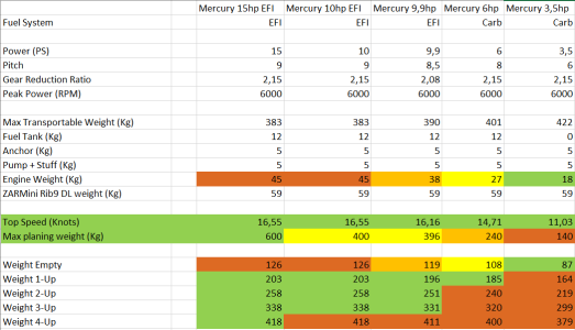

This post is for interest only, as the OP has a different set of criteria, but this was my decision making process.
I have a 2.7m ZARMini RIB 9 DL which had a 6hp Mercury 4 stroke engine on it (engine now sold) .... It would plane with one-up and the fuel tank in the bow-locker, but 2 up was not possible.
As already mentioned it depends on your personal usage pattern, we anchor some distance from civilisation quite often, so needed to be able to plane with 2 up and shopping. We also pull water toys with the RIB for kids, not very fast but fast enough to be fun. Wanted something with a bit more power. We also have an engine crane on the stern.
The RIB is rated up to 15hp but a 15hp 4 stroke is heavy (I liked the mercury 15hp but it is 45kg) - so I looked for a better compromise.
There is a formula for theoretical top-speed based on pitch, max rpm, and gear reduction ratio with some conversion factors to deliver top speed in knts. Max planing weight is simply engine power in Hp times 40.
Until recently, the 9,9hp was Carb, which put me off, but it has recently changed to EFI :love:
I created this table to get some logic into the decision ...
I wanted EFI to avoid regular carb cleaning and chokes, I wanted as light an engine as possible, and I wanted to be able to plane with 2-up and shopping.
The Mercury 9,9hp is a lighter 2 cylinder and fortunately, it is now EFI instead of Carb, so I pick it up on Saturday.
Theoretical top speed of 16 knots and planing with up to 331Kg all-up weight is OK, and 38kg will crane onto the stern rail better than the bigger engines.
Interesting number, but in my experience in dinghies is miles out. I have a 20hp on a tender and so should plane with 800kg, yet anything over 400kg will not plane. Another tender at 30hp has a weight limit to plane of 550kg and that’s a real struggle. My old one at 40hp would do 550kg easier, but not readily. So I suspect the correct figure is more like 20.
Baggywrinkle
6 Mar 2010
10,068
Can't remember where I got the rule of thumb from. It ties up well with my 6hp Mercury experience though, and a German test of 9,9hp outboards where a 3m aluminium RIB was the test boat.
Will question the dealer on Saturday, they have 15hp in stock too, and if they say the 9,9hp won't hack it, then it'll have to be the RIBs max of 15hp.
EDIT: Using 20 as the factor means my 6hp would not have planed with one-up - 6hpx20=120kg max planing weight
..... but boat 59kg + fuel 12kg + engine 27kg + other stuff 10kg + me 77kg = 185kg and had absolutely no problem planing, even one-up with a fat person (100kg) - two-up with my partner on board (+55kg) it was almost there when we were playing with the weight distribution.
