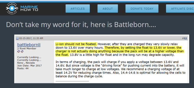

The voltage is relatively low per cell compared to 3.65v & all the papers & research I've come across seem to be OK with that, as soon as the voltage hits 13.8v it goes down. All "float" does is just mostly keeps up with the house loads apart from a tiny bit out/in as the mppt react slow. Too small to show up on the 0.1% resolution of SOC from the smartshunt. Almost identical setting to Rod Collins 15 year olds & he said just had them 2 years straight on float at 13.5v so seems OK. It's quite tricky as there basically is no data whatsoever, apart from this video now, about running LiFePo4 long term on a boat, not enough time gone by yet.
Update - found this on marineHowTo>
Drop-In LiFePo4- Be an Educated Consumer
Though disagree with the higher charging voltage of 14.2v, 13.8v is into the start of the top knee & very close to full anyway. Nothing much to be gained going higher in the real world with no balancing happening.
Just changed "float" to 13.25v / 3.3125v pc to see what happens.
