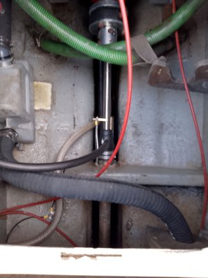

I'd be cautious here. It's common to connect the bonding circuit to the engine, which in turn creates a circuit to the prop and shaft via the gearbox (with a bridge wire across the coupling if it is of the flexible type). The fact that it creates a connection to the battery negative is incidental and of no concern.

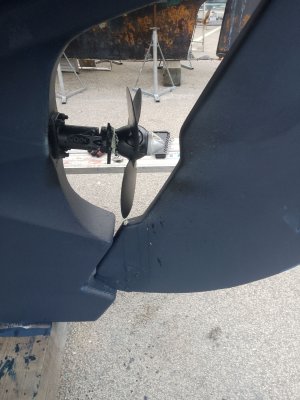

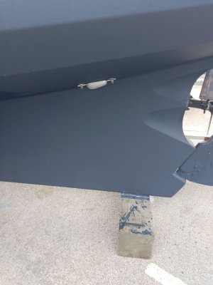

The anodes in the engine cooling system are unconnected with anything outside. They sit in a different body of water/electrolyte. The connection of the anodes to the engine block is quite normal as a path to the shafts. Have you check for continuity from the props to the hull anodes? - this is really the only thing that matters - and are the hull anodes doing anything?
I don't know about the example Paul quotes, but through hulls and valves are often made of plain brass and may dezincify. Bonding to anodes will not stop this. The best metal through hulls and valves are bronze or more recently DZR which is a brass with a small amount of arsenic in the alloy making it "Dezincification Resistant" and effectively as good as the more expensive bronze alloys. As I mentioned earlier the danger with wiring through hulls is that they could be connected to the DC circuits so creating a flow of current that would result in electrolytic action and subsequent corrosion. Very rare, but has been known.
Anodes are sacrificial - that is they introduce a less noble metal into the circuit which will erode in [reference to the less noble metal (usually zinc or aluminium) in the components that need protection. To work they need to be located in the same water and physically close in line of sight. Attaching directly as with prop anodes of on the shaft is best, next best is an anode attached to the hull as close a possible. The photo shows both on my boat - one on the end of the prop and a hull anode as close as we could get it connected to the shaft inside by a spring loaded brush. This requirement for be close in line of sight is another reason why bonding through hulls would not work as on most boats they are not in line of sight.
All understood.
Ref "and are the hull anodes doing anything?" well they are being consumed so I believe they are helping. In my case both shafts have brush gear attached to the "daisy chain" I mentioned.
I understand what actions to take.
