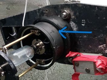

I have the LED bulb but how do I get the light unit apart ... I believe there is a locking ring but are you able to tell meow it all works as I was planning to do this up the mast.
The lens twists on then the locking ring secures. I've zoomed in and marked the fitting where you twist, the locking ring is at the blue arrow.

There are two versions of this aqua signal combined tricolour and anchor light. The more recent version is as in this picture. It has two locking rings. The top ring holds the lense assembly on and can be undone to replace bulbs. The bottom ring holds the complete assembly onto the female masthead socket that the assembly fits and connects to.
The older version has the same top lense and locking ring and a different base which just clips into the mast top socket.
I now have the skeleton left of the discontinued mark 2 model having used the lense to replace the brittle and badly faded coloured lense of a 1999 model with a virtually new one.
