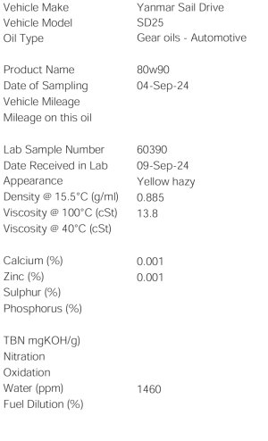

Water it was. Although the seals looked intact and no water in the bottom of the sail drive, they were replaced. Then after the boat went back in, the results of the oil test came back.
1460ppm water.

Not much but it seems gearbox oils need only 200 - 600 ppm. I cannot see this as a serious leak though.
The Yanmar techs couldn't find any problems and said the old seals looked OK but the foaming oil issue wasn't right so the cost was an investment vs trashing the saildrive.
