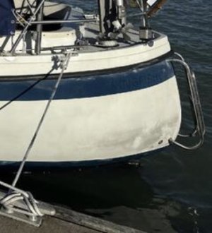

Have a look at this potential purchase, would that bottom worry you? Supposedly 7 year old replacement Volvo but listed as a MD2040 which is a much older engine isn’t it?

Might need a service of the injectors - injectors are a service item every so many hours; I think the 2030 needed them serviced every 200 hours. Not an expensive service. Ask the vendor for details of engine servicing.
No it would not bother me. Spot stains happen. Of course that doesn’t mean the engine shouldn’t be checked. I wash the underside of my stern quarter about twice a year to remove soot.
I have see this on a few boats.
I reckon that any diesel without a DPF is going to produce a bit of soot - that's what the DPF in cars is supposed to stop. It wouldn't worry me too much if the engine's otherwise healthy. My last boat was way overpowered - 28HP VP2003 in a Snapdragon 24. Because the engine wasn't working hard enough, it would clag up and start to smoke. A few minutes flat out laid a smoke screen like a destroyer on the Murmansk run, but it soon cleared, and we were good to go for another few months.

Could be over propped. Or even fouled prop. Re. engine - you could always get the numbers off it and ask Volvo. Adverts don't always contain the correct information.

Yes, the 2040 went out of production in 2004. As suggested the soot deposits could mean the injectors need checking but could also be causd by deposits built up particularly in the exhaust elbow from either too much light load running or because it is over propped. When engines are replaced some people use the old propeller or do not fit the correct size. That engine should run up to 3300-3600 rpm and cruise at 2400rpm. More info on the boat might help understand whether the engine is appropriate for the boat
