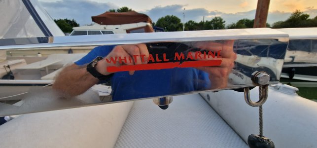

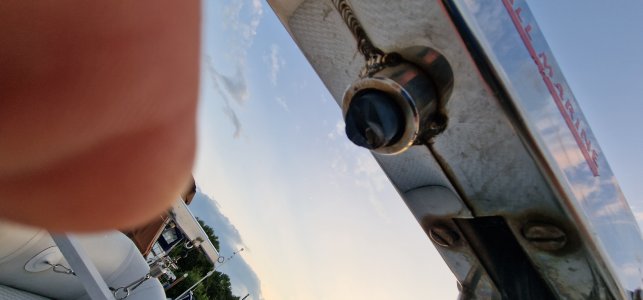

Hello all.
I have a set of Whittall Davits. The bit that unscrews on the underside to allow the extension arm to slide out has been snapped off by the previous owner or one before them. I don't seem able to locate anyone that does spare parts and understand that Whittall has gone out of business.
I have unscrewed the nylon bit as far as a dare, but it hits a lot of resistance before it would unwind completely and pop out (using some grips on it). Does anyone know if i can get a replacement or if this will turn all the way out for me to take somewhere to get one made up etc.
Pictuers attached.
Thanks in advance.

Ive just had one made in stainless , its not a metric thread , I think it was a UNF thread so you either need an engineer with an old threader or you need to find a bolt to adapt, my stainless guy has no more UNF bolts in stock .
It was a difficult manufacture as the size has to be exact as it acts as a brake.
Looking at your photo I would leave it in place and first lubricate it and ensure it is moving freely then just drill the end to fit an M3 or M4 3 inch bolt , you could then remove the bolt and fit a drilled cap / stainless tube before putting the bolt back but that would have no other purpose than cosmetic to hide the broken bit ( you cant file the broken bit level as you need the strength to hold the bolt) .
