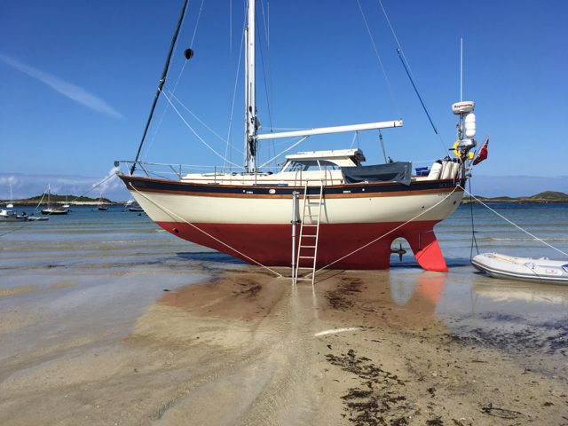

Long keels tend not to have skegs or am i misunderstanding what a long keel is? Am i thinking of a full keel or a long fin maybe? Oh and a Vancouver 34 would be fine.
Dunno if the name if long keel (full is when it deepens at the stern?) but she's not a fin and has a skeg. I assume she's built for that sort of thing (the manual states a couple of modifications for ocean crossings) but the skipper isn't yet.
I’d describe it as long keeled with rudder supported by a skeg. It’s not a common design. Most long keeled boats have their rudders supported on the aft end of the keel as has been pointed out by many people in this thread.
If someone asked me my subjective opinion and someone said it is a long keel, i would agree. If they said she was a full keel i would agree as well. I have never thought of any boat with a fin keel as being anything else other than a long fin. I think i would be wrong to call her a long fin though. I think a Venn diagram is needed for this.
That's very nice, but I wonder if that vestigial skeg is actually any stronger than a well designed spade rudder?
Don't confuse the issue with facts... The OP's friend is convinced that spade rudders are the work of the devil, therefore there's no arguing. (Personally I think he's been reading too many dramatic accounts without realising that thousands of modern yachts with spade rudders and fin keels sail across oceans every year without incident.).
Dunno, I think it's been on there 46 years. Wasn't really a make or break for me as I don't have enough experience to make those sort of judgements. I looked at fin / spade boats too but fell for that one.
