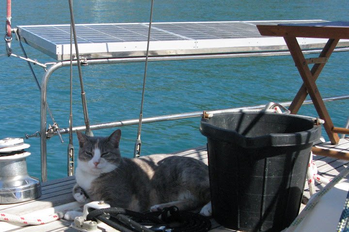

With Bob on this one. We preferred not to erect a 'goal post' so went for the aft side rails. Have a look here:
If you look closely behind bucket and cat you will see the assembly, which is easily raised or lowered as required.
We chose 3 separate panels side by side, which fit perfectly inside the guard rails, when lowered. Each panel is 40w, so we have a total of 240w, giving us up to 16amps on a good, sunny day with all panels in sunshine. The advantage of 3 smaller panels on each side (apart from looking neat) is that if shadow falls on one the other two still work perfectly. Our panels are Kyocera, bought locally through the dealer in Marmaris, who is an electrician and helped install them. The stainless steel work was also done in the local 'sanayi' (industrial estate). If anyone needs a contact name for the supplier please pm me.
