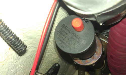

Whats is this thing in my F43?

IMAG0126 by KajLehtinen, on Flickr
or another picture

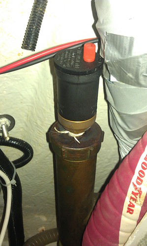

IMAG0128 by KajLehtinen, on Flickr
Anyone that has an idea?
/Kaj

Automatic air vent.
http://www.honeywelluk.com/products/Valves/Other-Valves/EA122/

It looks to be an automatic air vent and is fitted to a strainer, I would think it is to allow air into the system when turned off so that you dont get back flow (syphon effect) into the engine or generator.
If you remove the head you will find it has a needle valve attached to a float which when water is flowing will lift and shut off the bleed hole.
I assume it is to work like this.
http://sailmagazine.com/boatworks/engines-and-systems/anti-siphon_valves/
