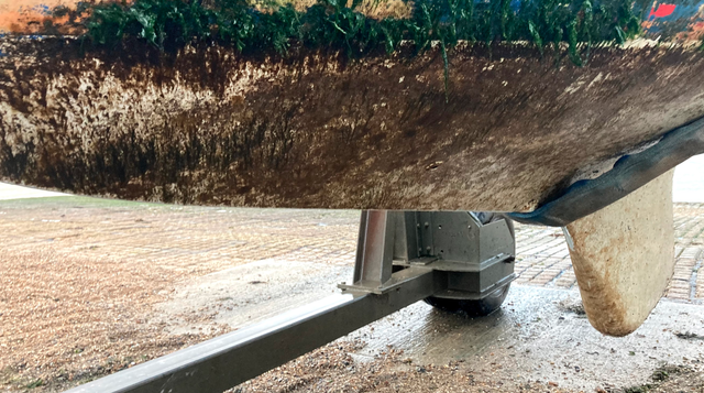

What I might did wrong with my antifauling?
I have a diver clean my boat every two weeks for the season - and i don't race it.
This is not an uncommon practice in the USA, as i don't think anyone expects bottom paint to do the job by itself.
it seems that in Britain, the belief is that one can just paint the bottom, and expect it to stay clean all season- is that right?
Even though I don't race my boat, i do use a racing paint - VC Offshore by Interlux. although one can touch up a bit it pretty much needs to be professionally sprayed. It is a very hard paint that burnishes to quite a smooth, even shiny, surface.
I just hauled my boat for the season, and there was more crud than I was happy with - i was thinking of having a word with the diver...
Why are you using hard antifoul? Soft is far better for a yacht and no need to have professionals spray it or have a diver to clean it every two weeks.
I was under the impression from both these companies that the paint was licenced for commercial use only....
Mille NCT from hempel is professional application only and the two pack one from international (I cant remember the name of) which I expect is ok if wearing the correct pipe.
Antifouling for ships generally relies on a faster sea service speed 20 or so knots than most sailors achieve. Also they are designed for short stationary periods, so may not work as well as you might assume and also leech more into the environment than your fair share to boot.
In the OP's case it seems not enough of it applied and perhaps a different product next time.

Please see the photos. The boat launched in July, retrieved end of October. One layer of flag cruising, except keel, where I put 2 layers. Was my first AF job. I got the boat just antifauled in 2019, probably using flag and there was just a little bit of slime... And used this to paint: No Nonsense 9
Photos:
UMM, seems to be a claasic case of you get what you pay for, and the paint used is a cheap one and one or two coats from a roller is nowhere near enough paint to work well for a year plus. It's failed completly near the waterline, probably because the paint fell off or is just too thin .

It's not a lack of stirring problem, as the paint has failed along the waterline only. The lower hull just needs a wipe.

Three months to get like that is absurdly poor. Having said that I would always use at least two coats all over and extra on high friction areas like the rudder. Was the paint genuine or did it come from some dodgy bloke down the pub?
I used Cruiser Uno for several years and put two or three coats on. It would work well for about six months and then it would start to grow a beard. This would easily erode off with use and I could get up to 18 months out of it if used regularly. Then I was offered a half used 20 litre tin of Hempel Olympic which you cant officially buy as a private customer but this was surplus from a local fishing boat. That was three years ago and it now needs redoing especially the rudder which has very little paint left on it. Jotun do something similar with the same restrictions if you can get it. Way to go.
How can you get Jotron tin based in the UK ??
2 or 3 coats might be enough on the keel, but not along the waterline. If you want cheap paints to work for at least a year, use 2 or 3 coats of scrubbable all over, then overcoat it with a good rub off ablative, BUT concentrate on areas near the waterline or where the hydraulic flow is turbulent, like the rudder aft of the prop. The combination of the 2 types of paint should be effective enough for 2 years, if you get lucky. The job can be done in one warm day if you have the gear to spray the paint on. Not sure if that is allowed in any UK yard or not, but spraying produces a better even result. AF paint is toxic to breath, so you will need a forced air system, or scuba gear!
