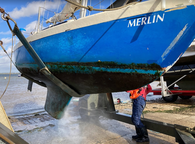

What I might did wrong with my antifauling?
slawosz
26 Sep 2018
600
London
Boat ashore. It seems to be better this year, although there was thick amount of growth, but like 1-2 mm, not more. I am thinking about putting coppercoat, but is a bit complicated, lot can go wrong. Price is not huge for all the years that I won't need to do anything. And I can scrub coppercoat mid season with brush. This year, I scrubbed AF with soft cloth mid July.

Looks like you used a cheap antifouling like Dulux. Forget Coppercoat, just buy a strong antifoul like CU45 from SLM Paints.

Coppercoat is AMAZING stuff. Just make sure that you get it applied properly. Ideally, sprayed on in a shed in the middle of summer.
Had my boat done three years a go and a wipe down to remove the slime is all it needs. I was lifted out this winter since getting it done and it did not even need a power wash. In three years it has almost paid for itself. It is rated to last 10 years so I've another seven years of cost, and ball aching, free antifouling.

Agree. Get hold of some commercial quality antifoul and it should last you three years. Cheaper than coppercoat especially if you go shares with three or even four other smallish boats

+1. If you have a long time horizon with the boat, then Coppercoat is a good investment. It works - far more people are satisfied than the odd one who says it does not. The main complaints come poor adhesion to iron keels or poor application.

No wonder the OP is confused. So much scattered advise.
And missing information. If he said what paint he used, I missed it. Soft vs. hard, multi-season vs. single. No mention of surface prep. No pictures or descriptions of other boats from his area, since they are all different.
I just place panels with ~ 25 paints in the wate for a long term test. 6 are on the boat. We'll see.

Regarding paint, I used Flag Cruising. I think I mentioned it somewhere - but thread grow quite a lot.
Regarding Coppercoat - I know it has mixed opinions. I am planning to do it exactly as manufacturer said. There is lot of interesting materials on the YT and they give some advice. Even if I will have some growth it will be less then now, will be much easier to clean in using brush or jet wash. Plus no antifauling job before season. I might take a look into some products mentioned here as well.

That is just the nature of the beast. No one type of AF is best, nor does paying more necessarily get better results. Add to that some treatments are better (or worse) in one location compared with another, and even in the same location from year to year. The magazines here have done regular tests like yours over the years with different formulations in different locations using both test panels and real boats. All this does is confirm my second sentence.
Coppercoat if properly applied is generally good as an antifoul in most situations and cleans off more easily than others, usually just a wash, but its real bonus is the life between recoating and the lower annual cost and workload - particularly if you pay for annual antifoul.

To the OP; The fouling on your boat seems to be mainly vegetative, rather than marine mollusc. Marine plant life thrives best when light levels are highest, e.g. less fouling in Winter than in Summer, more fouling near the surface. The deeper you go under the surface, the less the light penetrates. This is demonstrated by the distribution of fouling on your hull and keel. You would perhaps have been better off having put one coat on the keel and two on the hull:)
But, as advised above two thick coats all over, plus an extra coat on the leading edges of the rudder, keel and forefoot seems about right. The best tool to use is a 'wooly' roller on a radiator roller frame. The short roller can allow your efforts to conform to concave curves more effectively as well as the lighter weight aspect mentioned above. Attached is Internation Yacht Paint's guide book, where there are formulae for calculating quantities on Page 4. To be sure you have the correct thickness of antifouling on your hull, buy the correct quantity for your boat and keep painting until it is used up.

You cannot effectively scrub an ablative paint like Flag Cruising. You probably scrubbed off most of the paint. It also appears to be a super low-end paint for low fouling areas (read the label) I would not expect to work well. Try Pettit Odyssy HD as an economical alternative. But good AF paint is not cheap. Sorry to bear bad news. Pettit Odyssy Triton is very good and several times as expensive as what you paid.
If you feel in-water scrubbing will be needed, use a hard paint.
There are VERY few reports of success with Coppercoat in high fouling areas like yours. Surface prep must be near perfect, and I think you will be disappointed. There are good reasons it is not popular, but we could all be wrong.
Try reading the PBO review.PBO review. In the US, Practical Sailor reviews paints.

My friends boat in portsmouth harbour which is generally high fouling has copper coat.. It was not doing that great, probably because the boat was not used for a long period.. He threw caution to the wind and attacked in with p80 and electric sander.. since then im astonished how well its been working over the past year...
One problem with commercial for sailing boats is that its generally for ships that rarely stop and do an average of 18 knts.. It is not great on small private leisure boats..

Hempel Globic and Jotun Quantum Ultra - 2 excellent AF - professional use only. Globic is better than Olympic - both Globic and Quantum are expensive. Quantum was the AF of choice for Maersk (if its good enough for them, its good enough for me!(
Apply any AF liberally - don't try to eke it out (which is what most appear to do) - spread it thickly - its thickness that does the work not getting the colour coverage, If you spread it thinly it simply will not last long - and slipping is a large part of your AF costs. If you are having your AF done by a sub-contractor specifiy what AF you want used - and check they use it (appear unexpectedly and check the tins! - you are paying).
Jonathan
I was under the impression from both these companies that the paint was licenced for commercial use only....
Mille NCT from hempel is professional application only and the two pack one from international (I cant remember the name of) which I expect is ok if wearing the correct pipe.
Antifouling for ships generally relies on a faster sea service speed 20 or so knots than most sailors achieve. Also they are designed for short stationary periods, so may not work as well as you might assume and also leech more into the environment than your fair share to boot.
In the OP's case it seems not enough of it applied and perhaps a different product next time.
Would you care to expand on this and provide some concrete evidence to support the statement - which in itself does not make sense. Surely if it is no good in heavy fouling areas you would get large numbers of reports of failure rather than " VERY few reports of success". Surely if it is successful people are unlikely to report on it - in general people only complain of lack of success.
BTW I would not call the OPs level of fouling particularly heavy given that he used a low cost basic product. Much the same as I would get in the past in an all year round marina berth with a similar AF. In the same berth with Coppercoat I just get slime. Note that the waterline on his boat needs raising, but pretty sure that coppercoat would be a good investment - and would work as an effective antifoul - if he was keeping the boat.
