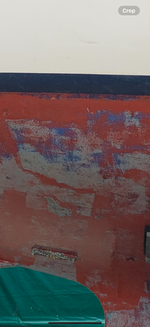

So I’ve always wanted to do coppercoat but never had the chance to sand blast off all the old antifoul. However there isn’t much of a layer of antifoul on my boat but there is a bomb hard layer of primer.
Then recently I was walking past a boat in Mylor and ask them what they were doing as it looked like the yard was about to do coppercoat. It looked like my hull, mostly grey but with a few very small bits of green showing through.
They said it had already been sand blasted.
So that made me think the gel shield on my boat is actually grey and I was mistakenly thinking it was the original antifoul primer. This does account for why it’s so god same hard to remove even with a very good scraper!
See pic attached. Red and blue is clearly old antifoul after being jet washed. Is the grey gelshield which was out on by the previous owner about 10 years ago, and then there is a slight bit of green in the odd place which I’m thinking is original gelcoat?

Think green and grey could both be Gelshield. The application involves a build of alternating colour coats of green and grey
Arr ok that’s interesting.
So if the grey is bloody hard and can only be removed with a sharp scraper, then the chances are that it is in fact gel shield and not very very well adhered antifoul primer from over 8 years ago prior to my ownership of the boat?

The presence of Gelshield would indicate either a previous osmosis treatment, or, an anti osmosis precaution. If it,s the former, then the original gelcoat has probably been removed altogether

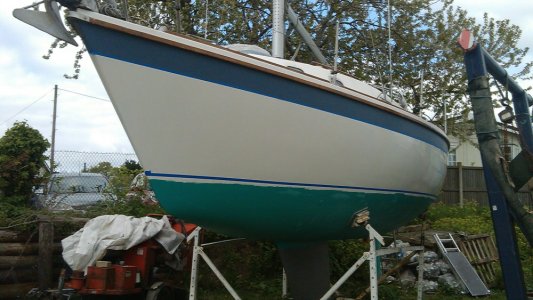

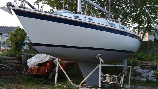

Here are a few photos of GelShield being applied to Concerto back in early 2014 after the hull had been fully stripped of antifouling and the gel coat sanded.

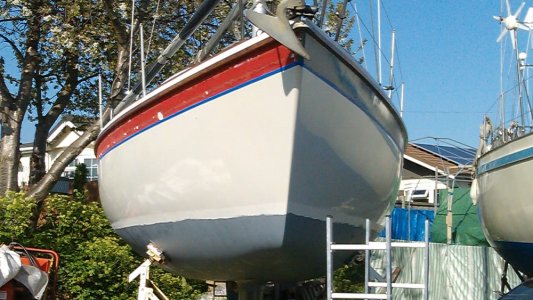

These colours are used to show an even oat before the next coat is the alternate colour. I then applied 2 coats of dark blue hard antifouling before 2 coats of Dover White soft antifouling. If I ever see dark blue, then all of the self polishing antifouling has been washed away - but never seen yet after many further coats of self polishing, but useful if I wish to wet sand back to reduce the layers. The photo below shows what Concerto looked like when ready for launching with Dover White (it is grey before entering the water) and the style line was painted in Oxford Blue and the boot top was black.
