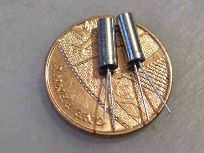

As the movement is probably the standard type used in these clocks, It's almost invariably the 'clock
crystal' (32.7khz) that has failed, if you are handy with a small soldering iron it's quite easy to replace and they only cost less than about £0.50 each.
Otherwise Poinards list of movement supplies is a good option.

The last time I changed the 'clock' on one of my boat clocks, it was easier to cut the legs and solder the replacement to the legs. It's worth putting a heatsink between where you are soldering and the clock unit, a pair of tweezers work well for this.
For ref' see the image for what these crystal look like and the size of them.
