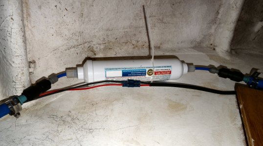

I swapped over to using 'fridge' filters using these people... Fridge filter kit
Because my boat had old fashioned 'hosepipe' I had to get various adapters to get it all to fit.
I now buy my filters off Amazon eg Cartridges
One thing to note, the pipes used by the filters are much smaller so my Whale flipper pumps are much harder to operate. I also have an electric water pump and that seems to have no difficulty.

Thanks for that.
