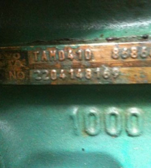

Thanks folks.
It's a shaft drive boat
They owner sent me a photo showing the engine running. And being revv'd
But when the revs are lifted off the (with the screw top lid off the coolant reservoir) the coolant overflows.

Coolant will expel with the cap off as the water pump is trying to circulate around the block and system but the thermostats are closed so water will find its own way to expand out the header tank .
