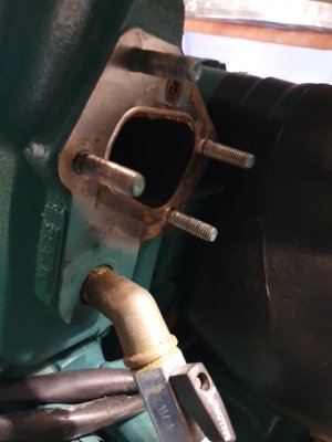

There seems to be a metal plate between the heat exchanger and the previous elbow, which is in good condition - see photo.
This looks to be fairly attached to the heat exchanger. I assume this does not need to be removed, just add the new gasket and elbow?

Well the heat gun plus flat screwdriver and silicone spray got the exhaust hose off - thanks for the tips. And from there it was easy to fit the new elbow.
