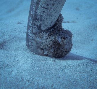

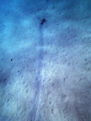

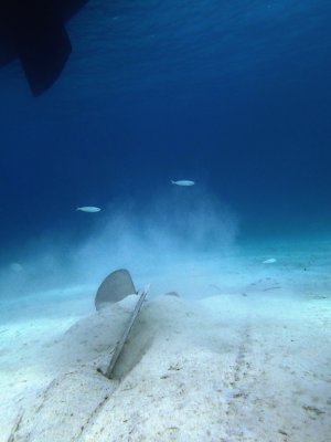

Testing anchors for their holding capacity is conducted at 'infinite' scope. The anchor is tensioned in one direction only and the anchor continues to dive as the tension increases (until about 2,000kg for a 15kg NG anchor). In holding capacity tests the rode is effectively on the seabed.
When a yacht is yawing and the rode is constantly thrashing the seabed the conditions are very different to the controlled holding capacity tests. The constant movement of the rode will allow the anchor to be constantly twitching and the shear strength of the seabed will be compromised. There will be an increased vertical element to the tension when the chain is thrashing. If you dive on your anchor in benign conditions on a short scope and touch your anchor you will find that the anchor is constantly twitching - the constant twitch will reduce the shear strength of the seabed. If your anchor is well buried use a long screw driver to touch the anchor to feel the twitches.
A riding sail or anchoring in a fork will steady the yacht and calm the thrashing of the rode. A snubber will also reduce the twitching of the anchor - but if you believe in snubbers you will be using one every time you anchor.
If the veering is caused by the wind direction constantly changing, williwaws, a riding sail might make the situation worse and a second anchor, in a fork, is an answer, extend the rode or move.
The closer you can manage your ground tackle to copy holding capacity tests, a steady tension on the anchor or anchors in one direction, the greater the opportunity to set the anchor more and more deeply - simulating the holding capacity tests. You then can expect the anchor to dive more and more deeply with little negative impact of reduced shear strength of the seabed.
Your problem then becomes - how long will it take to retrieve the anchor once it is more deeply set :)
The deeper your anchor(s) are buried the more stable they will be as the shank (and fins of the Odin) act as vertical flukes and increase hold in lateral directions. Similarly the more deeply your anchor is set the more chain you can bury the more stable your anchor - as the buried chain will be less able to transmit twitching to the anchor. For most anchors the depth of set of the toe and the shackle are similar (as the anchors dives at roughly 30 degrees. A shallow set anchor, especially a large one may have considerable difficulty burying chain as the shank is difficult to bury - and needs more setting room.
The thinner the rode, smaller, better shackles, no swivel the easier the rode will bury (its the anchor that is dragging the rode into the seabed).
