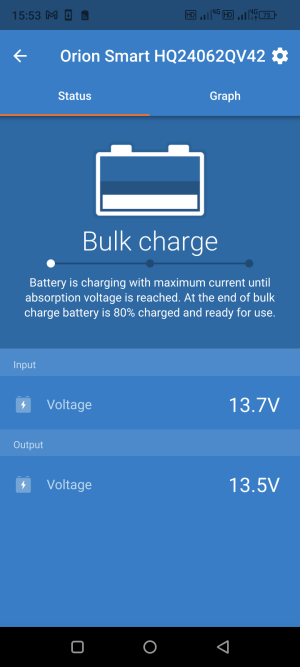

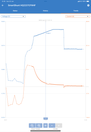

I have attached two screen grabs that may provide some clue(s)
First seems to be what it is doing according to its own Bluetooth and the second are the defaults for lithiums, again according to itself. I don't have a grab of the readout from the battery monitor...
