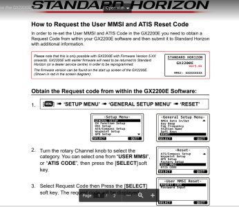

I tried inputting a new MMSI number into my fixed VHF. Stupidly, I hadn't realised that the same number stays with the same boat and VHF. Instead I attempted to transfer my MMSI over from my old boat and Off Com Licence. I now have a VHF that requires professional resetting.
My question is should I just get a new radio and install it? and is the only other way to resolve the issue is to remove the VHF entirely and take it to get it done professionally? I'm thinking that may be more costly and perhaps more grief?
