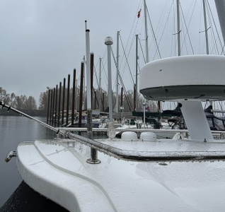

Seems like maybe the right forum? Will do more digging on the boat, but any idea what the antenna behind the light and radar is for? About 2' tall.
Cheers!
