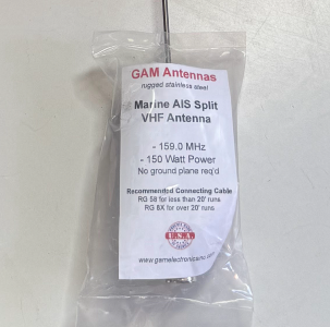

Meant to include in the original message. Have heard good thing about Metz. I have had good experience with GAM Antennas. Also, if you have AIS and a splitter, you should think about getting an antenna tuned for both AIS and VHF. Cheers!
There are much better cables than RG58 available now for similar prices.
