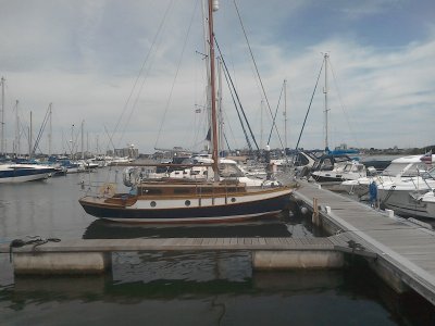

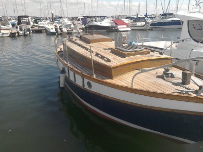

Not sure about the need for undercover storage. In my experience of owning wooden boats the best place is in the water with a good overall cover, well ventilated. The hull is happier in water rather than propped up and dry. The big problem with wood boats, particularly with lots of brightwork on deck like this one is fresh water and damp. The photos are of my old Eventide which was laid up outside under cover for 8 years before I sold it and all thaat was needed was a good wash down of the teak deck and a rub down and recoat of the Woodskin. the photos were taken in 2019. The current owner has just sent a recent photo and she still looks the same. Mast was refinished then with Cetol and still looks good. The hull is sheathed ply so less susceptible to being out of the water. The Toplac was then about 10 years old and needed only a bit of local touching up.
Once you get on top of the finishing using modern products and protect the boat over the winter keeping it up to scratch is not difficult or time consuming. Pity I am 80 on Sunday and not 70 as I would be sorely tempted by this LG design. A year's hard graft and £50k to get a boat that would cost 4 times that to build . If done properly and kept in the way I described it would give as good service as a new GRP boat.

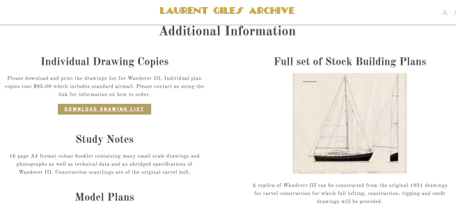

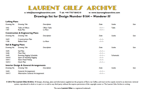

The easiest solution would be to purchase the drawings of the Wanderer III sailplan and rig from the Laurent Giles Archive*; which sells copies of all the plans for this design. Or the current owner may have obtained them when he acquired the boat from the college.
From those plans, whoever took on this project would know what he was looking for when trying to source his spars.
